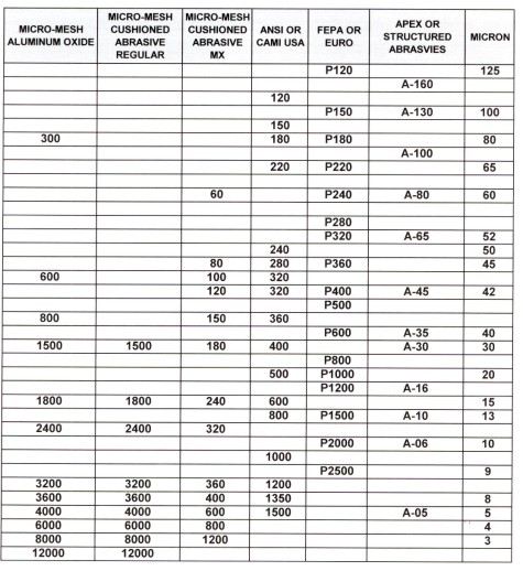

Keep in mind there are two different grading systems for sandpapers -
European (FEPA, or P-grade) and North American (CAMI). The systems are
very different, and I don't have a list of who uses which. A CAMI graded 800
for example, is about the same as a P-1500. A CAMI 1500 would probably
come to around 4000 rated in FEPA / P-grade. Make sure you know which
grading system your abrasive is using before placing a big order.

Good point David, and when speaking of MicroMesh there is a third. Here is a comparison chart for MicroMesh to FEPA and CAMI

What David said and Michael's chart. Mixing the two systems can produce nightmares.   Took me a while to figure out what was causing my nightmares.

[QUOTE=npalen] What David said and Michael's chart. Mixing the two systems can produce nightmares.   Took me a while to figure out what was causing my nightmares.
Yeper it will really mess you up as you get to finner papers. Just try to remove CAMI 400 scratches with FEPA 600. Then you suddenly realise you going up in micron instead of down
